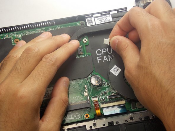

  12. Dell Inspiron 15-7547 Motherboard Replacement, CPU Fan: crwdns2935265:012crwdnd2935265:01crwdnd2935265:02crwdne2935265:0 Dell Inspiron 15-7547 Motherboard Replacement, CPU Fan: crwdns2935265:012crwdnd2935265:02crwdnd2935265:02crwdne2935265:0
    • Remove the two 5.0 mm-long Philips #0 screws from the fan.
    • The screw marked in orange will remain captive to the fan.
  13. Dell Inspiron 15-7547 Motherboard Replacement: crwdns2935265:013crwdnd2935265:01crwdnd2935265:02crwdne2935265:0 Dell Inspiron 15-7547 Motherboard Replacement: crwdns2935265:013crwdnd2935265:02crwdnd2935265:02crwdne2935265:0
    • Disconnect the wire that connects the fan to the motherboard. This can be found under the flap directly to the left of the fan.
  14. Dell Inspiron 15-7547 Motherboard Replacement: crwdns2935265:014crwdnd2935265:01crwdnd2935265:01crwdne2935265:0
    • Lift the fan out of the chassis.

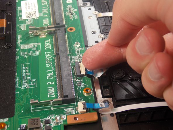

    • Unlatch the ribbon cable by pulling the white release up.
    • If this proves to be difficult using your fingers, try a plastic spudger.
    • Hold the blue flap and pull to unplug the cable.

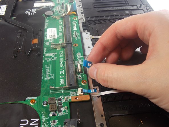

  23. Dell Inspiron 15-7547 Motherboard Replacement: crwdns2935265:023crwdnd2935265:01crwdnd2935265:03crwdne2935265:0 Dell Inspiron 15-7547 Motherboard Replacement: crwdns2935265:023crwdnd2935265:02crwdnd2935265:03crwdne2935265:0 Dell Inspiron 15-7547 Motherboard Replacement: crwdns2935265:023crwdnd2935265:03crwdnd2935265:03crwdne2935265:0
    • Unlatch black release on the ribbon cable.
    • Hold the blue flap to unplug the cable.
  24. Dell Inspiron 15-7547 Motherboard Replacement: crwdns2935265:024crwdnd2935265:01crwdnd2935265:03crwdne2935265:0 Dell Inspiron 15-7547 Motherboard Replacement: crwdns2935265:024crwdnd2935265:02crwdnd2935265:03crwdne2935265:0 Dell Inspiron 15-7547 Motherboard Replacement: crwdns2935265:024crwdnd2935265:03crwdnd2935265:03crwdne2935265:0
    • Unlatch the ribbon cable by pulling the black release up.
    • Unlike the others, this release is found at the back.
    • Hold the flap and unplug the cable.
  25. Dell Inspiron 15-7547 Motherboard Replacement: crwdns2935265:025crwdnd2935265:01crwdnd2935265:03crwdne2935265:0 Dell Inspiron 15-7547 Motherboard Replacement: crwdns2935265:025crwdnd2935265:02crwdnd2935265:03crwdne2935265:0 Dell Inspiron 15-7547 Motherboard Replacement: crwdns2935265:025crwdnd2935265:03crwdnd2935265:03crwdne2935265:0
    • Unlike the others this release is found at back.
    • Hold the blue flap and unplug the cable.
