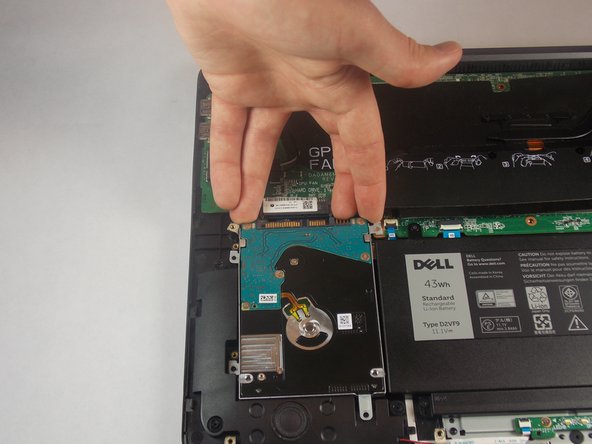

    • Remove the four 5.0 mm-long Philips #0 screws connecting the hard drive to the chassis.
  4. Dell Inspiron 15-7547 Hard Drive Replacement: crwdns2935265:04crwdnd2935265:01crwdnd2935265:02crwdne2935265:0 Dell Inspiron 15-7547 Hard Drive Replacement: crwdns2935265:04crwdnd2935265:02crwdnd2935265:02crwdne2935265:0
    • Disconnect the hard drive from the motherboard by placing your fingers at the back, and pulling forward towards the front of the chassis.
  5. Dell Inspiron 15-7547 Hard Drive Replacement: crwdns2935265:05crwdnd2935265:01crwdnd2935265:01crwdne2935265:0
    • Lift the hard drive out of the chassis.
