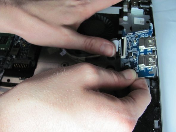

  16. Dell Inspiron 15-7537 USB Board Replacement, USB Board: crwdns2935265:016crwdnd2935265:01crwdnd2935265:02crwdne2935265:0 Dell Inspiron 15-7537 USB Board Replacement, USB Board: crwdns2935265:016crwdnd2935265:02crwdnd2935265:02crwdne2935265:0
    • Pull back the tape that is securing the cable to the USB board.
  17. Dell Inspiron 15-7537 USB Board Replacement: crwdns2935265:017crwdnd2935265:01crwdnd2935265:03crwdne2935265:0 Dell Inspiron 15-7537 USB Board Replacement: crwdns2935265:017crwdnd2935265:02crwdnd2935265:03crwdne2935265:0 Dell Inspiron 15-7537 USB Board Replacement: crwdns2935265:017crwdnd2935265:03crwdnd2935265:03crwdne2935265:0
    • Lift the black latch and remove the USB cable from the USB board.
