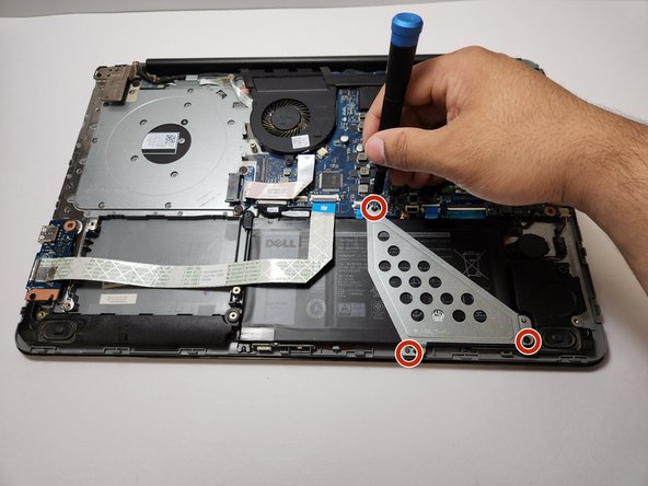

  5. Dell Inspiron 15-5565 Battery Replacement, Battery: crwdns2935265:05crwdnd2935265:01crwdnd2935265:02crwdne2935265:0 Dell Inspiron 15-5565 Battery Replacement, Battery: crwdns2935265:05crwdnd2935265:02crwdnd2935265:02crwdne2935265:0
    • Remove the three 5 mm screws from the battery bracket using a Phillips #00 screwdriver.
  6. Dell Inspiron 15-5565 Battery Replacement: crwdns2935265:06crwdnd2935265:01crwdnd2935265:03crwdne2935265:0 Dell Inspiron 15-5565 Battery Replacement: crwdns2935265:06crwdnd2935265:02crwdnd2935265:03crwdne2935265:0 Dell Inspiron 15-5565 Battery Replacement: crwdns2935265:06crwdnd2935265:03crwdnd2935265:03crwdne2935265:0
    • Remove the five 5 mm screws from the outer edges of the battery using a Phillips #00 screwdriver.
    • Remove the battery from the laptop.
