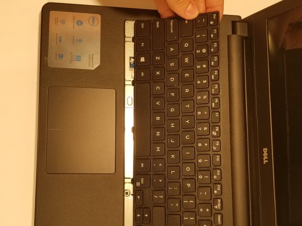

  5. Dell Inspiron 15-5552 CD-Drive Replacement, Keyboard: crwdns2935265:05crwdnd2935265:01crwdnd2935265:02crwdne2935265:0 Dell Inspiron 15-5552 CD-Drive Replacement, Keyboard: crwdns2935265:05crwdnd2935265:02crwdnd2935265:02crwdne2935265:0
    • Keyboard
    • Insert a spudger next to the 5 plastic indents located at the top of the keyboard and gently pry to release the securing clips.
  6. Dell Inspiron 15-5552 CD-Drive Replacement: crwdns2935265:06crwdnd2935265:01crwdnd2935265:02crwdne2935265:0 Dell Inspiron 15-5552 CD-Drive Replacement: crwdns2935265:06crwdnd2935265:02crwdnd2935265:02crwdne2935265:0
    • Lift the keyboard off of the computer. *Be careful not to tear the ribbon that attaches the back of the keyboard to the computer when lifting it.*
  7. Dell Inspiron 15-5552 CD-Drive Replacement: crwdns2935265:07crwdnd2935265:01crwdnd2935265:01crwdne2935265:0
    • Flip the keyboard over onto the palm-rest assembly.
  8. Dell Inspiron 15-5552 CD-Drive Replacement: crwdns2935265:08crwdnd2935265:01crwdnd2935265:02crwdne2935265:0 Dell Inspiron 15-5552 CD-Drive Replacement: crwdns2935265:08crwdnd2935265:02crwdnd2935265:02crwdne2935265:0
    • Flip the black securing bar near the base of the ribbon with a spudger to release the ribbon from the computer.
