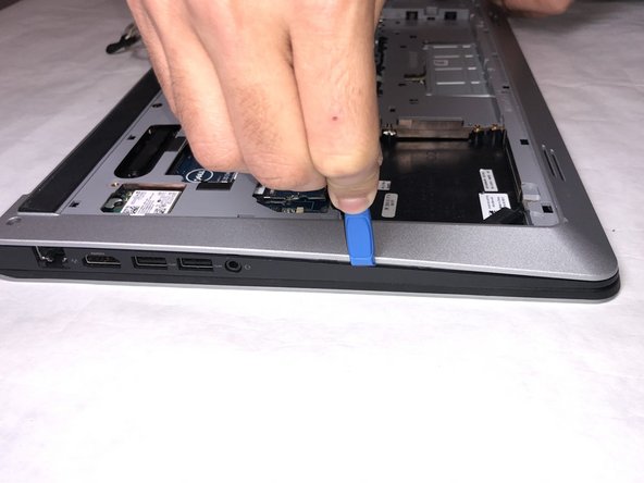

    • Use the spudger to carefully remove the back cover to get into the internals. Stick the spudger into the slot indicated in the photo by the marker.
    • Pry up from the slot, then pry up around the sides of the panel. The panel can then be removed by lifting the side with the slot and puling in that direction.

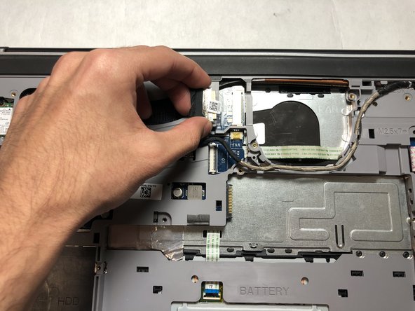

    • Start by removing the white ribbon cable. Lift up the black tab indicated by the red marker to disconnect the ribbon cable from the connector. Be careful while removing the ribbon cable, as it will possibly be taped to the fan.

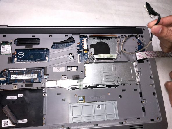

    • After you have removed the ribbon cable, locate the screws indicated in the photo by the red markers (2 in total) and remove them with a Phillips J0 screwdriver.
  6. Dell Inspiron 15-5547 Trackpad Replacement: crwdns2935265:06crwdnd2935265:01crwdnd2935265:01crwdne2935265:0
    • Remove the fan cable, indicated by the red marker in the picture, by pulling it out from the connector. Be careful to pull it out by the plastic end instead of by the cable.
  7. Dell Inspiron 15-5547 Trackpad Replacement: crwdns2935265:07crwdnd2935265:01crwdnd2935265:01crwdne2935265:0
    • Once you have disconnected the fan from the motherboard, you may now remove the fan from the slot. Your laptop should now look similar to the picture in this step.

    • Disconnect the plug indicated in the picture so as to not damage it.
    • Gently remove the cable from the groove holding it in place to completely free the cable.
    • Gently use force until it is unplugged, do not use excess force as it will damage the cable.

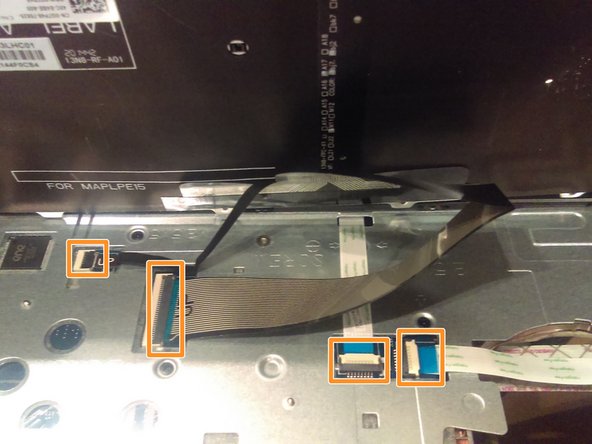

    • Use a spudger or plastic opening tool to lift up the keyboard using the notches indicated.
    • Carefully lift the keyboard but do not lift it up all the way, as there are cables you need to unplug before you completely separate the keyboard from the body.
    • Detach the cables connecting the keyboard to the motherboard before removing the keyboard from the device.

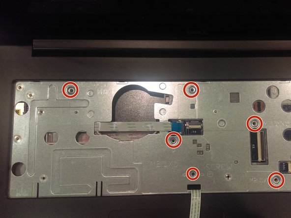

  10. Dell Inspiron 15-5547 Trackpad Replacement: crwdns2935265:010crwdnd2935265:01crwdnd2935265:02crwdne2935265:0 Dell Inspiron 15-5547 Trackpad Replacement: crwdns2935265:010crwdnd2935265:02crwdnd2935265:02crwdne2935265:0
    • Remove ten screws using a Phillips #0 screwdriver.

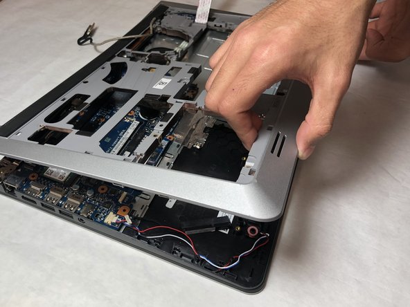

    • Using the Phillips #0 screwdriver, remove sixteen screws from the case.
    • Using the iFixit Opening Tool, pry open the edges of the panel and remove.

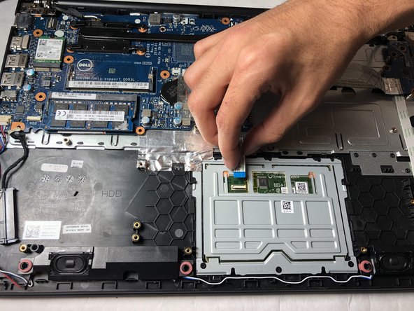

  12. Dell Inspiron 15-5547 Trackpad Replacement: crwdns2935265:012crwdnd2935265:01crwdnd2935265:03crwdne2935265:0 Dell Inspiron 15-5547 Trackpad Replacement: crwdns2935265:012crwdnd2935265:02crwdnd2935265:03crwdne2935265:0 Dell Inspiron 15-5547 Trackpad Replacement: crwdns2935265:012crwdnd2935265:03crwdnd2935265:03crwdne2935265:0

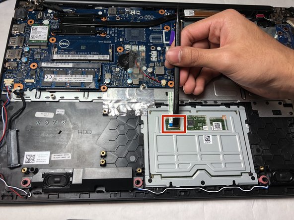

    • Lift up the black tab indicated in the picture using a spudger.
    • Detach the trackpad cable from the device.

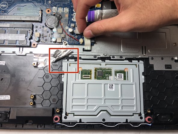

  13. Dell Inspiron 15-5547 Trackpad Replacement: crwdns2935265:013crwdnd2935265:01crwdnd2935265:02crwdne2935265:0 Dell Inspiron 15-5547 Trackpad Replacement: crwdns2935265:013crwdnd2935265:02crwdnd2935265:02crwdne2935265:0
    • Pull back the metallic tape to expose the trackpad.
    • Be sure not to apply excess force as it might tear the tape.

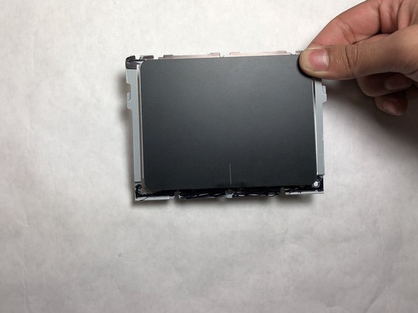

  14. Dell Inspiron 15-5547 Trackpad Replacement: crwdns2935265:014crwdnd2935265:01crwdnd2935265:03crwdne2935265:0 Dell Inspiron 15-5547 Trackpad Replacement: crwdns2935265:014crwdnd2935265:02crwdnd2935265:03crwdne2935265:0 Dell Inspiron 15-5547 Trackpad Replacement: crwdns2935265:014crwdnd2935265:03crwdnd2935265:03crwdne2935265:0

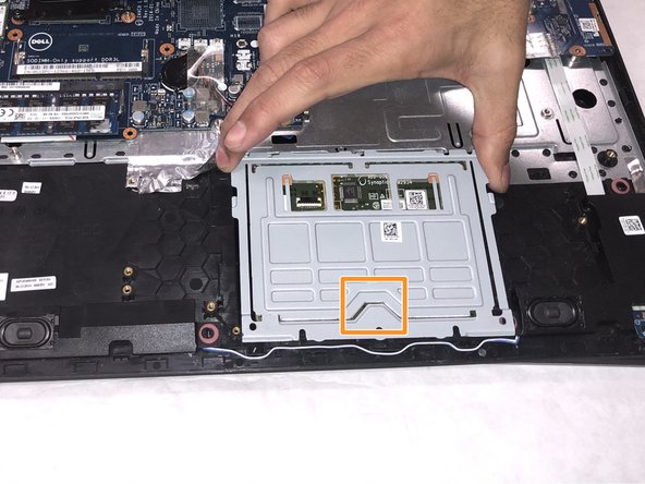

    • Using a Phillips #0 screwdriver, remove the three screws.
    • Lift up the trackpad and remove it from the device.
    • Make sure to pull the trackpad by sliding it vertically as shown in the second picture. Do not pull it straight up as there is a notch that needs to be avoided.
