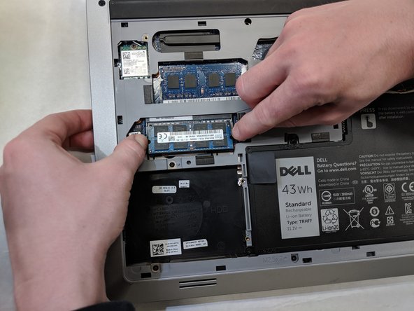

    • The RAM components of the laptop can be found in the following locations.
    • Pull the two side brackets of the bottom RAM component horizontally. This will free the component.
    • Lift and remove the RAM component from its location.
    • Be careful with the RAM components as they are fragile.
  4. Dell Inspiron 15-5547 RAM Replacement: crwdns2935265:04crwdnd2935265:01crwdnd2935265:02crwdne2935265:0 Dell Inspiron 15-5547 RAM Replacement: crwdns2935265:04crwdnd2935265:02crwdnd2935265:02crwdne2935265:0
    • Repeat the previous steps for the top RAM slot.
    • Apply slight pressure onto the RAM to lock it in during the reassembly.
