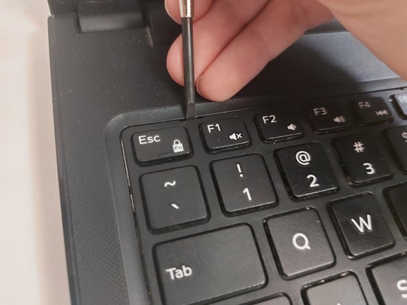

  9. Dell Inspiron 15-3567 Fan Replacement, Remove the Keyboard - Release the Tabs: crwdns2935265:09crwdnd2935265:01crwdnd2935265:02crwdne2935265:0 Dell Inspiron 15-3567 Fan Replacement, Remove the Keyboard - Release the Tabs: crwdns2935265:09crwdnd2935265:02crwdnd2935265:02crwdne2935265:0
    • 5 little tabs are located on the keyboard.
    • Use a flat-head screwdriver to poke into those tabs.
  10. Dell Inspiron 15-3567 Fan Replacement, Remove the Keyboard - Lift the Keyboard: crwdns2935265:010crwdnd2935265:01crwdnd2935265:03crwdne2935265:0 Dell Inspiron 15-3567 Fan Replacement, Remove the Keyboard - Lift the Keyboard: crwdns2935265:010crwdnd2935265:02crwdnd2935265:03crwdne2935265:0 Dell Inspiron 15-3567 Fan Replacement, Remove the Keyboard - Lift the Keyboard: crwdns2935265:010crwdnd2935265:03crwdnd2935265:03crwdne2935265:0
    • After all 5 tabs are pushed, you should be able to lift the keyboard up a litte
    • Slowly pull the keyboard up toward the screen.
    • A cable is connected between the laptop and the keyboard, so be very careful while lifting the keyboard up.
