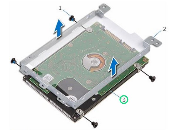

  5. Dell Inspiron 15 5566 Memory Modules Replacement, Remove the Screws: crwdns2935265:05crwdnd2935265:01crwdnd2935265:01crwdne2935265:0
    • Remove the four screws (M3x3) that secure the hard-drive bracket to the hard drive.
  6. Dell Inspiron 15 5566 Memory Modules Replacement, Lifting the Hard Drive Bracket: crwdns2935265:06crwdnd2935265:01crwdnd2935265:02crwdne2935265:0 Dell Inspiron 15 5566 Memory Modules Replacement, Lifting the Hard Drive Bracket: crwdns2935265:06crwdnd2935265:02crwdnd2935265:02crwdne2935265:0
    • Lift the hard-drive bracket out of the hard drive.
  7. Dell Inspiron 15 5566 Memory Modules Replacement, Placing the Hard Drive Bracket: crwdns2935265:07crwdnd2935265:01crwdnd2935265:01crwdne2935265:0
    • Place the hard-drive bracket on the NEW hard drive.
  8. Dell Inspiron 15 5566 Memory Modules Replacement, Align the Screw Holes: crwdns2935265:08crwdnd2935265:01crwdnd2935265:01crwdne2935265:0
    • Align the screw holes on the hard-drive bracket with the screw holes on the hard drive.
  9. Dell Inspiron 15 5566 Memory Modules Replacement, Replace the Screws: crwdns2935265:09crwdnd2935265:01crwdnd2935265:01crwdne2935265:0
    • Replace the four screws (M3x3) that secure the hard-drive bracket to the hard drive.
