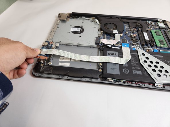

  5. Dell Inspiron 15 5565 IO Board Replacement, IO Board: crwdns2935265:05crwdnd2935265:01crwdnd2935265:03crwdne2935265:0 Dell Inspiron 15 5565 IO Board Replacement, IO Board: crwdns2935265:05crwdnd2935265:02crwdnd2935265:03crwdne2935265:0 Dell Inspiron 15 5565 IO Board Replacement, IO Board: crwdns2935265:05crwdnd2935265:03crwdnd2935265:03crwdne2935265:0
    • Lift up the cover to pull out the cable.

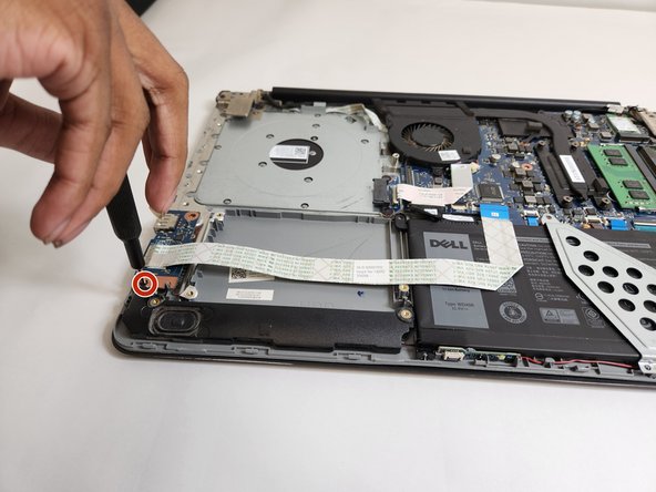

  6. Dell Inspiron 15 5565 IO Board Replacement: crwdns2935265:06crwdnd2935265:01crwdnd2935265:03crwdne2935265:0 Dell Inspiron 15 5565 IO Board Replacement: crwdns2935265:06crwdnd2935265:02crwdnd2935265:03crwdne2935265:0 Dell Inspiron 15 5565 IO Board Replacement: crwdns2935265:06crwdnd2935265:03crwdnd2935265:03crwdne2935265:0
    • Remove the single 5 mm screw from the main part of the IO board using a Phillips #00 screwdriver.
    • Remove the IO board from the device.
