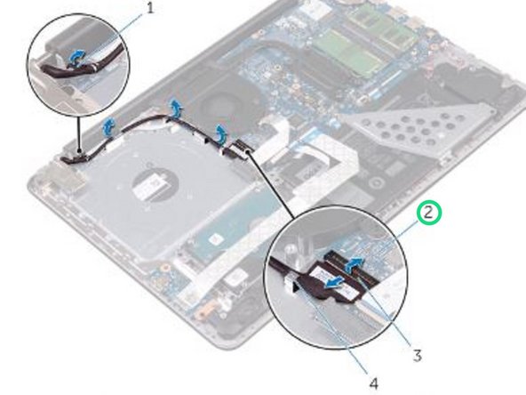

  2. Dell Inspiron 15 5565 Display Assembly Replacement, Remove the Display Cable: crwdns2935265:02crwdnd2935265:01crwdnd2935265:01crwdne2935265:0
    • Note the display cable routing and remove the cable from its routing guides.
  3. Dell Inspiron 15 5565 Display Assembly Replacement, Disconnect the Display Cable: crwdns2935265:03crwdnd2935265:01crwdnd2935265:02crwdne2935265:0 Dell Inspiron 15 5565 Display Assembly Replacement, Disconnect the Display Cable: crwdns2935265:03crwdnd2935265:02crwdnd2935265:02crwdne2935265:0
    • Lift the latch and disconnect the display cable from the system board.

  10. Dell Inspiron 15 5565 Display Assembly Replacement, Routing the Display Cable: crwdns2935265:010crwdnd2935265:01crwdnd2935265:01crwdne2935265:0
    • Route the display cable through the routing guides on the palm rest and keyboard.
  11. Dell Inspiron 15 5565 Display Assembly Replacement, Sliding the Display Cable: crwdns2935265:011crwdnd2935265:01crwdnd2935265:02crwdne2935265:0 Dell Inspiron 15 5565 Display Assembly Replacement, Sliding the Display Cable: crwdns2935265:011crwdnd2935265:02crwdnd2935265:02crwdne2935265:0
    • Slide the display cable to the connector on the system board and close the latch to secure the cable.
