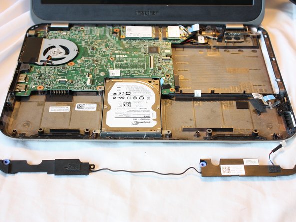

  23. Dell Inspiron 14z-5423 Speaker Replacement, Speaker: crwdns2935265:023crwdnd2935265:01crwdnd2935265:01crwdne2935265:0
    • Release the wire connecting the speakers from the securing clips by pulling them upward.
  24. Dell Inspiron 14z-5423 Speaker Replacement: crwdns2935265:024crwdnd2935265:01crwdnd2935265:02crwdne2935265:0 Dell Inspiron 14z-5423 Speaker Replacement: crwdns2935265:024crwdnd2935265:02crwdnd2935265:02crwdne2935265:0
    • Using a rolling motion, remove the speakers from the base of the computer
    • Adhesive foam secures the speakers to the base so you may encounter some resistance.
