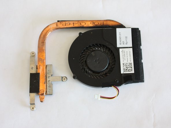

  30. Dell Inspiron 14z-5423 Fan  Replacement, Fan: crwdns2935265:030crwdnd2935265:01crwdnd2935265:02crwdne2935265:0 Dell Inspiron 14z-5423 Fan  Replacement, Fan: crwdns2935265:030crwdnd2935265:02crwdnd2935265:02crwdne2935265:0
    • Flip the motherboard over.
    • Locate the red and yellow wires attached to the fan and gently detach them from the motherboard.
  31. Dell Inspiron 14z-5423 Fan  Replacement: crwdns2935265:031crwdnd2935265:01crwdnd2935265:02crwdne2935265:0 Dell Inspiron 14z-5423 Fan  Replacement: crwdns2935265:031crwdnd2935265:02crwdnd2935265:02crwdne2935265:0
    • Using a J0 tipped screwdriver remove the three 5 mm Phillips head screws that attach fan to the motherboard.
    • The fan base is labeled 1, 2, 3. Make sure you unscrew the screws in this order.
    • The screws are attached to the fan and will fully unscrew.
  32. Dell Inspiron 14z-5423 Fan  Replacement: crwdns2935265:032crwdnd2935265:01crwdnd2935265:02crwdne2935265:0 Dell Inspiron 14z-5423 Fan  Replacement: crwdns2935265:032crwdnd2935265:02crwdnd2935265:02crwdne2935265:0
    • Remove the fan from the motherboard by lifting upwards.

Hurrah, just used these instructions to replace my fan and have a beautifully silent working laptop again - thanks! I skipped steps 20-23, and it would have been useful to have a mention that thermal compound was necessary to make a good connection when replacing the heat sink - but all in all great clear instructions. One happy good-as-new laptop owner!
Tanya Cowan - crwdns2934203:0crwdne2934203:0
This guide was bloody marvellous! This was the first time I’ve opened a laptop by myself and it was quite a ride but a fun one the only struggle that I had was the bloody blue ribbon connecting to the motherboard other than that the rest was really easy to follow. Thank you so much for the guide and I hope I can some day be a contributor just as great as you random internet person ^^
waluilli - crwdns2934203:0crwdne2934203:0
