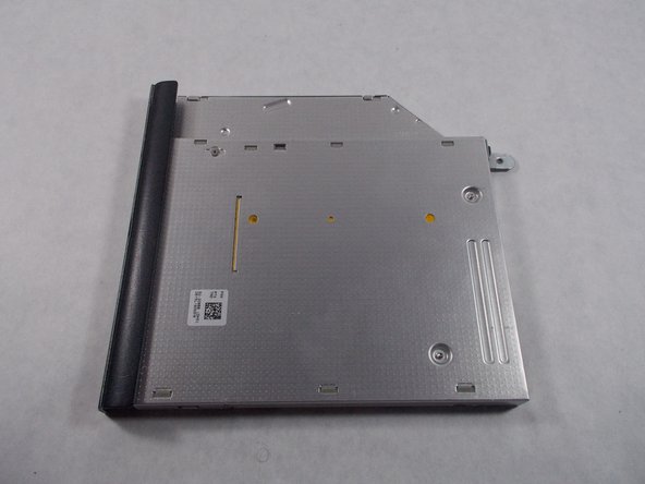

    • Push the two sliders away from the battery towards the outer edges.
  2. Dell Inspiron 14R-5421 CD Drive Replacement: crwdns2935265:02crwdnd2935265:01crwdnd2935265:02crwdne2935265:0 Dell Inspiron 14R-5421 CD Drive Replacement: crwdns2935265:02crwdnd2935265:02crwdnd2935265:02crwdne2935265:0
    • Remove the battery when it pops up.
  3. Dell Inspiron 14R-5421 CD Drive Replacement, CD Drive: crwdns2935265:03crwdnd2935265:01crwdnd2935265:01crwdne2935265:0
    • Remove the single screw that secures the cd drive to the laptop noted by the red circle
  4. Dell Inspiron 14R-5421 CD Drive Replacement: crwdns2935265:04crwdnd2935265:01crwdnd2935265:02crwdne2935265:0 Dell Inspiron 14R-5421 CD Drive Replacement: crwdns2935265:04crwdnd2935265:02crwdnd2935265:02crwdne2935265:0
    • Now just pull the cd drive until it disconnects from the computer
