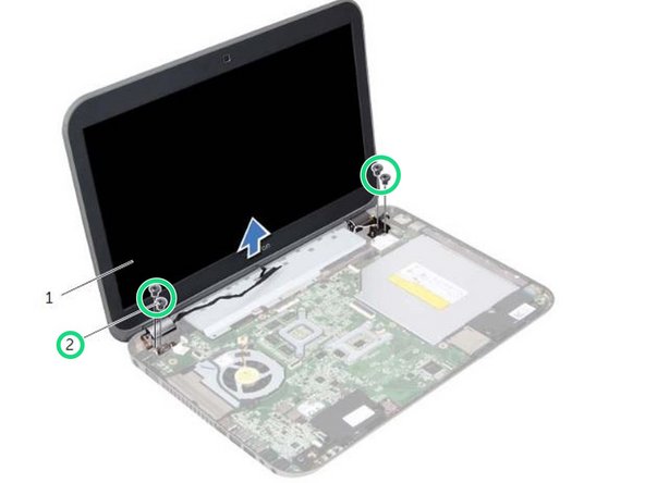

  5. Dell Inspiron 14R SE 7420 Display Assembly Replacement, Remove the Screws: crwdns2935265:05crwdnd2935265:01crwdnd2935265:01crwdne2935265:0
    • Remove the screws that secure the display assembly to the computer base.
  6. Dell Inspiron 14R SE 7420 Display Assembly Replacement, Lifting the Display Assembly: crwdns2935265:06crwdnd2935265:01crwdnd2935265:01crwdne2935265:0
    • Lift the display assembly off the computer base.
  7. Dell Inspiron 14R SE 7420 Display Assembly Replacement, Placing the Display Assembly: crwdns2935265:07crwdnd2935265:01crwdnd2935265:02crwdne2935265:0 Dell Inspiron 14R SE 7420 Display Assembly Replacement, Placing the Display Assembly: crwdns2935265:07crwdnd2935265:02crwdnd2935265:02crwdne2935265:0
    • Place the display assembly in position and replace the screws that secure the display assembly to the computer base.
