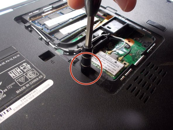

    • Remove all of the 6 mm screws on the bottom of the laptop.
    • There are some that go along the edge and some that are surrounding and underneath the middle plate.
  5. Dell Inspiron 1440 Speaker Replacement: crwdns2935265:05crwdnd2935265:01crwdnd2935265:02crwdne2935265:0 Dell Inspiron 1440 Speaker Replacement: crwdns2935265:05crwdnd2935265:02crwdnd2935265:02crwdne2935265:0
    • Remove the 6 mm screws that are in the silver metal plate under the keyboard
    • Disconnect any wires that are attached to the metal plate.
  6. Dell Inspiron 1440 Speaker Replacement: crwdns2935265:06crwdnd2935265:01crwdnd2935265:02crwdne2935265:0 Dell Inspiron 1440 Speaker Replacement: crwdns2935265:06crwdnd2935265:02crwdnd2935265:02crwdne2935265:0
    • Once all of the screws are out of the silver plate and the bottom of the laptop, pull silver plate, which is attached to the silver plastic on top, off of the laptop.
  7. Dell Inspiron 1440 Speaker Replacement: crwdns2935265:07crwdnd2935265:01crwdnd2935265:03crwdne2935265:0 Dell Inspiron 1440 Speaker Replacement: crwdns2935265:07crwdnd2935265:02crwdnd2935265:03crwdne2935265:0 Dell Inspiron 1440 Speaker Replacement: crwdns2935265:07crwdnd2935265:03crwdnd2935265:03crwdne2935265:0
    • Remove the 4 mm screws on either end of each speaker. Once they are removed, pull up the speaker.
