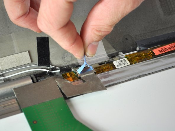

    4. Dell Inspiron 1420 Display Replacement, Removing the Power Connector Cable: crwdns2935265:05crwdnd2935265:01crwdnd2935265:02crwdne2935265:0 Dell Inspiron 1420 Display Replacement, Removing the Power Connector Cable: crwdns2935265:05crwdnd2935265:02crwdnd2935265:02crwdne2935265:0
      • Pull directly up on the light blue tab.
