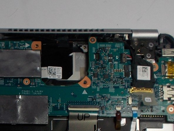

  4. Dell Inspiron 14-7437 Cooling Fan Replacement: crwdns2935265:04crwdnd2935265:01crwdnd2935265:01crwdne2935265:0
    • Disconnect the ribbon cables from the motherboard.
  5. Dell Inspiron 14-7437 Cooling Fan Replacement: crwdns2935265:05crwdnd2935265:01crwdnd2935265:01crwdne2935265:0
    • Lift up and remove the Lithium-Polymer Battery.
  6. Dell Inspiron 14-7437 Cooling Fan Replacement, Cooling Fan: crwdns2935265:06crwdnd2935265:01crwdnd2935265:02crwdne2935265:0 Dell Inspiron 14-7437 Cooling Fan Replacement, Cooling Fan: crwdns2935265:06crwdnd2935265:02crwdnd2935265:02crwdne2935265:0
    • Remove the two 2.5 mm screws using a J000 Phillips Head Screwdriver.
  7. Dell Inspiron 14-7437 Cooling Fan Replacement: crwdns2935265:07crwdnd2935265:01crwdnd2935265:02crwdne2935265:0 Dell Inspiron 14-7437 Cooling Fan Replacement: crwdns2935265:07crwdnd2935265:02crwdnd2935265:02crwdne2935265:0
    • Pull up on the wire and remove the Cooling Fan.
