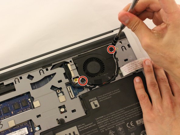

    • Move the cable over to the side to reveal the fan screws.
    • Remove the two black 5.70 mm screws from the fan.

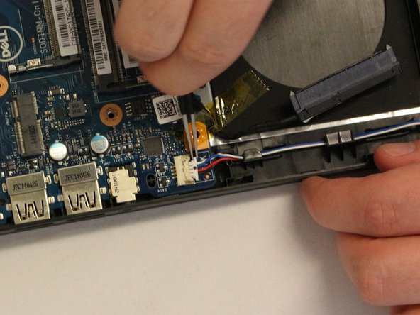

    • Locate the small wire plug on the bottom left of the motherboard.
    • Gently remove the wire plug with tweezers.
