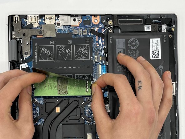

  3. Dell Inspiron 14-5415 RAM Replacement, RAM: crwdns2935265:03crwdnd2935265:01crwdnd2935265:01crwdne2935265:0
    • To access the Dell Inspiron RAM, turn the device upside down.
    • The fan should be positioned In the top right hand corner of the device.
    • The Dell logo on the battery pack should be in an upright position when locating parts.
  4. Dell Inspiron 14-5415 RAM Replacement: crwdns2935265:04crwdnd2935265:01crwdnd2935265:03crwdne2935265:0 Dell Inspiron 14-5415 RAM Replacement: crwdns2935265:04crwdnd2935265:02crwdnd2935265:03crwdne2935265:0 Dell Inspiron 14-5415 RAM Replacement: crwdns2935265:04crwdnd2935265:03crwdnd2935265:03crwdne2935265:0
    • Raise the thin plastic tab that is covering the RAM.
    • Gently dislodge the metal hooks that are on both sides of the RAM by slightly pulling them apart.
    • The metal hooks are very thin, be sure not to bend them while dislodging them.
  5. Dell Inspiron 14-5415 RAM Replacement: crwdns2935265:05crwdnd2935265:01crwdnd2935265:02crwdne2935265:0 Dell Inspiron 14-5415 RAM Replacement: crwdns2935265:05crwdnd2935265:02crwdnd2935265:02crwdne2935265:0
    • Gently pull on both sides the RAM to remove it.
    • Make sure to be gentle, as small scratches can permanently damage the RAM.
