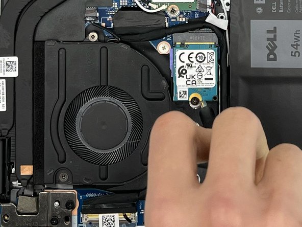

  3. Dell Inspiron 14-5415 Hard Drive Replacement, Hard Drive: crwdns2935265:03crwdnd2935265:01crwdnd2935265:02crwdne2935265:0 Dell Inspiron 14-5415 Hard Drive Replacement, Hard Drive: crwdns2935265:03crwdnd2935265:02crwdnd2935265:02crwdne2935265:0
    • Remove the screw from the hard drive using a Phillips #00 screwdriver.
  4. Dell Inspiron 14-5415 Hard Drive Replacement: crwdns2935265:04crwdnd2935265:01crwdnd2935265:01crwdne2935265:0
    • Carefully pull the hard drive out of its position.
    • Be sure to handle the hard drive with care. It should not need to be pulled hard to remove.
