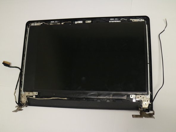

    • Using your fingertips, gently pry up the inner edges of the display bezel.
    • Lift the display bezel off the display assembly.

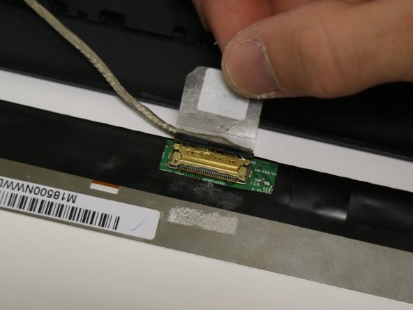

  17. Dell Inspiron 14-3452 Screen Replacement: crwdns2935265:017crwdnd2935265:01crwdnd2935265:03crwdne2935265:0 Dell Inspiron 14-3452 Screen Replacement: crwdns2935265:017crwdnd2935265:02crwdnd2935265:03crwdne2935265:0 Dell Inspiron 14-3452 Screen Replacement: crwdns2935265:017crwdnd2935265:03crwdnd2935265:03crwdne2935265:0
    • After removing the bezel, locate the tab indicated in the pictures.
    • Lift the tab as shown in the pictures.
    • Lift the gold latch securing the display cable to the socket.
    • Pull display cable away from the socket.
