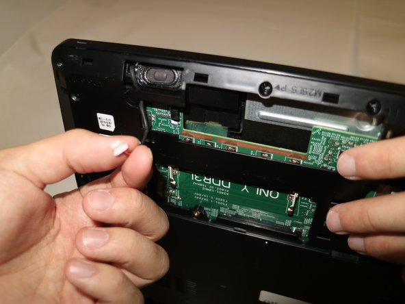

    • Using your fingertips remove the speaker cable from the motherboard by pulling the white connector away from the socket.

    • Pry apart keyboard assembly slowly as keyboard cable will still be attached to the motherboard.
    • Use the blue spudger to pry apart the keyboard assembly from the bottom shell.
