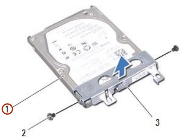

  3. Dell Inspiron 14 M4040 Hard Drive Replacement, Remove the Screws: crwdns2935265:03crwdnd2935265:01crwdnd2935265:01crwdne2935265:0
    • Remove the two screws that secure the hard-drive bracket to the hard drive.
  4. Dell Inspiron 14 M4040 Hard Drive Replacement, Placing the Hard Drive: crwdns2935265:04crwdnd2935265:01crwdnd2935265:02crwdne2935265:0 Dell Inspiron 14 M4040 Hard Drive Replacement, Placing the Hard Drive: crwdns2935265:04crwdnd2935265:02crwdnd2935265:02crwdne2935265:0
    • Place the hard-drive bracket on the NEW hard drive.
  5. Dell Inspiron 14 M4040 Hard Drive Replacement, Replace the Two Screws: crwdns2935265:05crwdnd2935265:01crwdnd2935265:01crwdne2935265:0
    • Replace the two screws that secure the hard-drive bracket to the hard drive.
