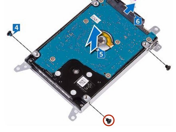

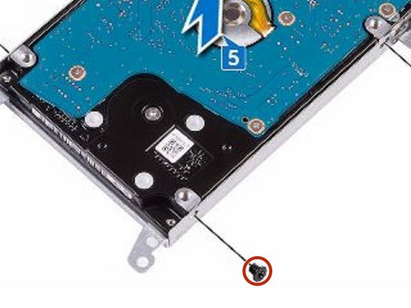

  4. Dell Inspiron 14 3462 Hard Drive Replacement, Remove the Screws: crwdns2935265:04crwdnd2935265:01crwdnd2935265:02crwdne2935265:0 Dell Inspiron 14 3462 Hard Drive Replacement, Remove the Screws: crwdns2935265:04crwdnd2935265:02crwdnd2935265:02crwdne2935265:0
    • Remove the four screws (M3x3) that secure the hard-drive bracket to the hard-drive assembly.
  5. Dell Inspiron 14 3462 Hard Drive Replacement, Lifting the Hard-Drive Assembly: crwdns2935265:05crwdnd2935265:01crwdnd2935265:01crwdne2935265:0
    • Lift the hard-drive assembly off the hard-drive bracket.
  6. Dell Inspiron 14 3462 Hard Drive Replacement, Disconnecting the Interposer: crwdns2935265:06crwdnd2935265:01crwdnd2935265:01crwdne2935265:0
    • Disconnect the interposer from the hard drive.
  7. Dell Inspiron 14 3462 Hard Drive Replacement, Connect the Interposer: crwdns2935265:07crwdnd2935265:01crwdnd2935265:01crwdne2935265:0
    • Connect the interposer to the NEW hard drive.
