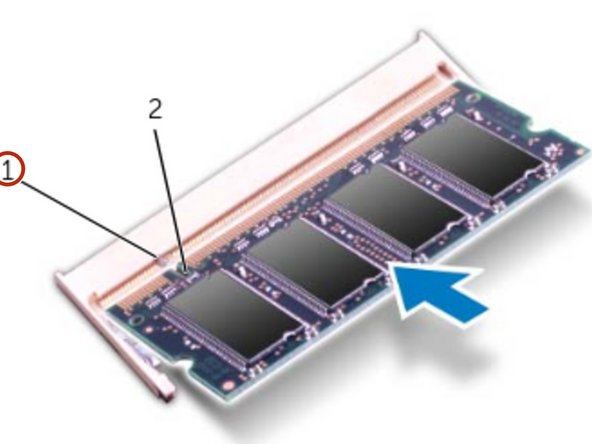

  3. Dell Inspiron 13z 5323 Memory Module Replacement, Align the Notch: crwdns2935265:03crwdnd2935265:01crwdnd2935265:02crwdne2935265:0 Dell Inspiron 13z 5323 Memory Module Replacement, Align the Notch: crwdns2935265:03crwdnd2935265:02crwdnd2935265:02crwdne2935265:0
    • CAUTION: If you need to install memory modules in two connectors, install a memory module in the connector labeled "DIMM A" before you install a memory module in the connector labeled "DIMM B."
    • Align the notch on the memory module with the tab on the memory-module connector.
  4. Dell Inspiron 13z 5323 Memory Module Replacement, Installing the Memory Module: crwdns2935265:04crwdnd2935265:01crwdnd2935265:01crwdne2935265:0
    • Slide the memory module firmly into the connector at a 45-degree angle, and press the memory module down until it clicks into place. If you do not hear the click, remove the memory module and reinstall it.
    • NOTE: If the memory module is not in stalled properly, the computer may not boot.
