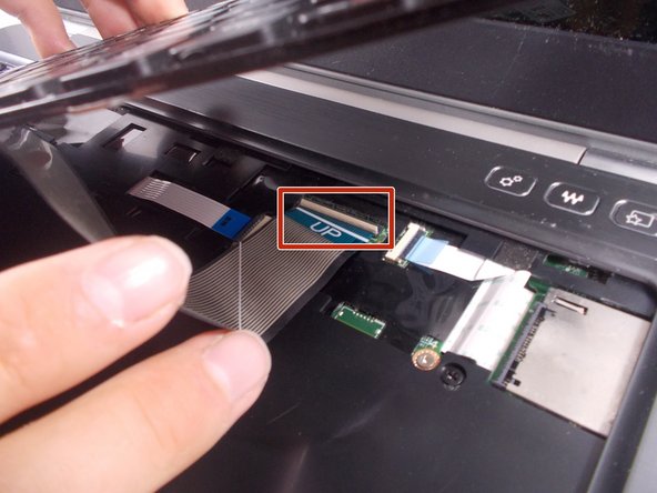

  3. Dell Inspiron 13z 5323 Keyboard Replacement: crwdns2935265:03crwdnd2935265:01crwdnd2935265:02crwdne2935265:0 Dell Inspiron 13z 5323 Keyboard Replacement: crwdns2935265:03crwdnd2935265:02crwdnd2935265:02crwdne2935265:0
    • The ribbon connector seen in yellow can be removed by flipping up the plastic hinge clamp with a thin plastic pry lever
