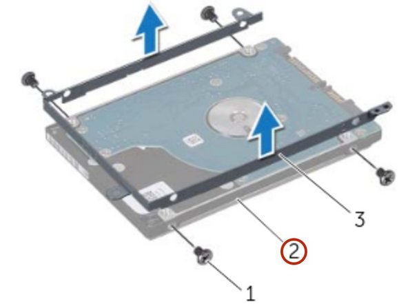

  4. Dell Inspiron 13z 5323 Hard Drive Replacement, Remove the Screws: crwdns2935265:04crwdnd2935265:01crwdnd2935265:01crwdne2935265:0
    • Remove the screws that secure the hard-drive bracket to the hard drive.
  5. Dell Inspiron 13z 5323 Hard Drive Replacement, Lifting the Hard-Drive Bracket: crwdns2935265:05crwdnd2935265:01crwdnd2935265:02crwdne2935265:0 Dell Inspiron 13z 5323 Hard Drive Replacement, Lifting the Hard-Drive Bracket: crwdns2935265:05crwdnd2935265:02crwdnd2935265:02crwdne2935265:0
    • Lift the hard-drive bracket off the hard drive.
