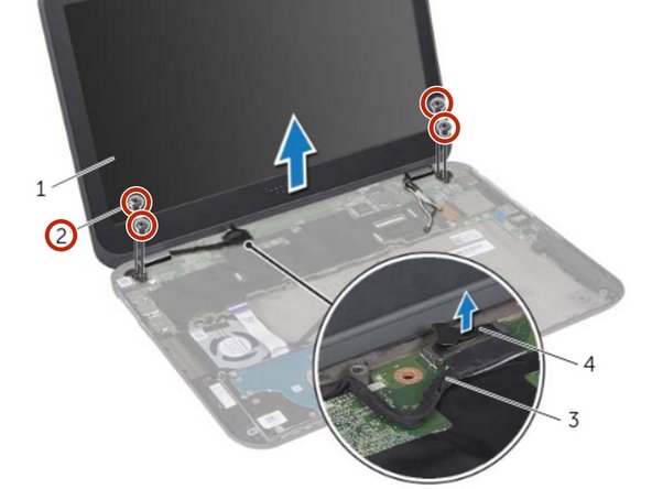

Dell Inspiron 13z 5323 Display Assembly Replacement
  1. Dell Inspiron 13z 5323 Display Assembly Replacement, Noting the Antenna Cables: crwdns2935265:01crwdnd2935265:01crwdnd2935265:02crwdne2935265:0 Dell Inspiron 13z 5323 Display Assembly Replacement, Noting the Antenna Cables: crwdns2935265:01crwdnd2935265:02crwdnd2935265:02crwdne2935265:0
    • WARNING: Before working inside your computer, read the safety information that shipped with your computer and follow the steps in "Before You Begin".
    • Pull the pull-tab to disconnect the display cable from the system-board connector.
  2. Dell Inspiron 13z 5323 Display Assembly Replacement, Remove the Screws: crwdns2935265:02crwdnd2935265:01crwdnd2935265:01crwdne2935265:0
    • Remove the screws that secure the display assembly to the computer base.
  3. Dell Inspiron 13z 5323 Display Assembly Replacement, Lifting the Display Assembly: crwdns2935265:03crwdnd2935265:01crwdnd2935265:01crwdne2935265:0
    • Lift the display assembly off the computer base.
  4. Dell Inspiron 13z 5323 Display Assembly Replacement, Replace the Screws: crwdns2935265:04crwdnd2935265:01crwdnd2935265:02crwdne2935265:0 Dell Inspiron 13z 5323 Display Assembly Replacement, Replace the Screws: crwdns2935265:04crwdnd2935265:02crwdnd2935265:02crwdne2935265:0
    • Place the NEW display assembly in position and replace the screws that secure the display assembly to the computer base.
  5. Dell Inspiron 13z 5323 Display Assembly Replacement, Connecting the Display Cable: crwdns2935265:05crwdnd2935265:01crwdnd2935265:01crwdne2935265:0
    • Connect the display cable to the system-board connector.
