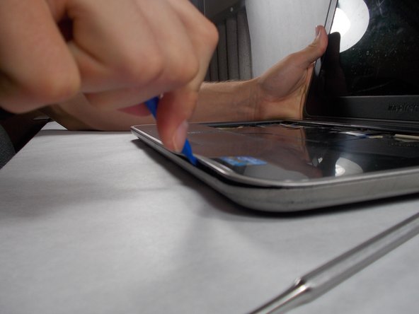

    • There are 3 slots on the top of the keyboard where you will have to use a thin tool, such as a flathead screwdriver to push the tabs so the keyboard will pop out.
    • Be careful when pushing in the keyboard tabs, as they may break if they if too much pressure is applied to them.
    • You will have to flip a small tab up where the ribbon connector goes into the insert, so the connector can be released and the keyboard can be removed.
  3. Dell Inspiron 13z 5323 Battery Replacement: crwdns2935265:03crwdnd2935265:01crwdnd2935265:03crwdne2935265:0 Dell Inspiron 13z 5323 Battery Replacement: crwdns2935265:03crwdnd2935265:02crwdnd2935265:03crwdne2935265:0 Dell Inspiron 13z 5323 Battery Replacement: crwdns2935265:03crwdnd2935265:03crwdnd2935265:03crwdne2935265:0
    • Remove the highlighted 4 screws and then use the plastic separator to remove the palm rest.
    • Be careful when separating the palm rest from the laptop, because being too aggressive with it can cause the small clips that hold the palm rest in place to break .

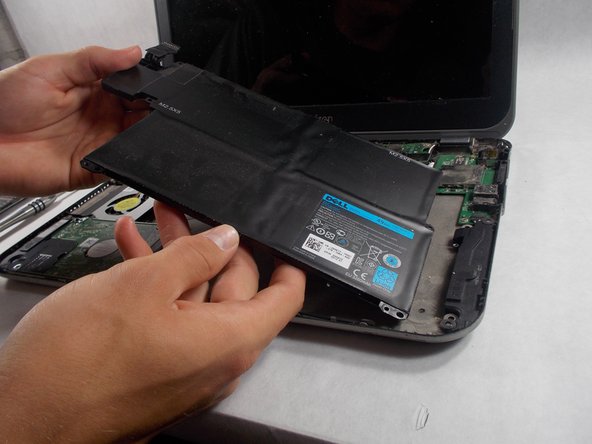

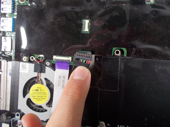

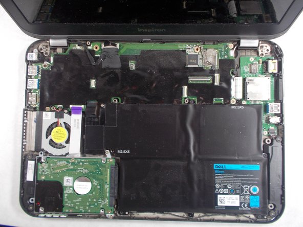

    • Remove the screws surrounding the battery and unplug the cable in the top left corner to then remove the battery.
