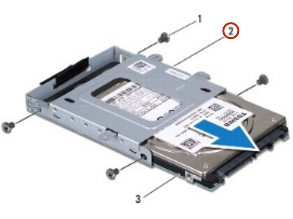

  4. Dell Inspiron 1320 Hard Drive Replacement, Remove the Screws: crwdns2935265:04crwdnd2935265:01crwdnd2935265:01crwdne2935265:0
    • Remove the four screws that secure the hard drive to the hard drive cage.
  5. Dell Inspiron 1320 Hard Drive Replacement, Sliding the Hard Drive: crwdns2935265:05crwdnd2935265:01crwdnd2935265:01crwdne2935265:0
    • Slide the hard drive out of the hard drive cage.
  6. Dell Inspiron 1320 Hard Drive Replacement, Sliding the Hard Drive: crwdns2935265:06crwdnd2935265:01crwdnd2935265:02crwdne2935265:0 Dell Inspiron 1320 Hard Drive Replacement, Sliding the Hard Drive: crwdns2935265:06crwdnd2935265:02crwdnd2935265:02crwdne2935265:0
    • Slide the NEW hard drive into the hard drive cage.
  7. Dell Inspiron 1320 Hard Drive Replacement, Replace the Screws: crwdns2935265:07crwdnd2935265:01crwdnd2935265:01crwdne2935265:0
    • Replace the four screws that secure the hard drive to the hard drive cage.
