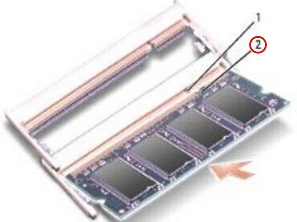

  4. Dell Inspiron 1300 Memory Modules Replacement, Align the Notch: crwdns2935265:05crwdnd2935265:01crwdnd2935265:02crwdne2935265:0 Dell Inspiron 1300 Memory Modules Replacement, Align the Notch: crwdns2935265:05crwdnd2935265:02crwdnd2935265:02crwdne2935265:0
    • Align the notch in the module edge connector with the tab in the connector slot.
  5. Dell Inspiron 1300 Memory Modules Replacement, Installing the Memory Module: crwdns2935265:06crwdnd2935265:01crwdnd2935265:01crwdne2935265:0
    • Slide the NEW module firmly into the slot at a 45-degree angle, and rotate the module down until it clicks into place. If you do not feel the click, remove the module and reinstall it.
