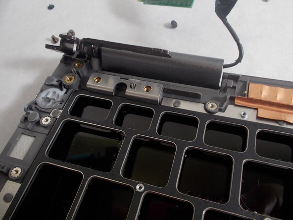

    • Use the Phillips #00 screwdriver to remove the eight 1mm screws at the back of the keyboard.
    • Remove the 3 screws holding the hinges of the laptop on each side.
  14. Dell Inspiron 13-7373 Keyboard Replacement: crwdns2935265:014crwdnd2935265:01crwdnd2935265:02crwdne2935265:0 Dell Inspiron 13-7373 Keyboard Replacement: crwdns2935265:014crwdnd2935265:02crwdnd2935265:02crwdne2935265:0
    • Lift up on the hinges that the three screws were removed from.
    • They are difficult to move and may require a tad bit more effort.
  15. Dell Inspiron 13-7373 Keyboard Replacement: crwdns2935265:015crwdnd2935265:01crwdnd2935265:02crwdne2935265:0 Dell Inspiron 13-7373 Keyboard Replacement: crwdns2935265:015crwdnd2935265:02crwdnd2935265:02crwdne2935265:0
    • Gently remove the keyboard from beneath the hinges that were lifted up.
