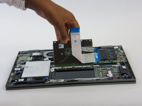

  6. Dell Inspiron 13-5368 Touchpad Replacement, Touchpad: crwdns2935265:06crwdnd2935265:01crwdnd2935265:02crwdne2935265:0 Dell Inspiron 13-5368 Touchpad Replacement, Touchpad: crwdns2935265:06crwdnd2935265:02crwdnd2935265:02crwdne2935265:0
    • Undo the clasps that hold the ribbon cables in place. Then, remove the ribbon cables.
  7. Dell Inspiron 13-5368 Touchpad Replacement: crwdns2935265:07crwdnd2935265:01crwdnd2935265:01crwdne2935265:0
    • Remove the 1.5mm Phillips #0 screws that hold the touchpad to the laptop case.
  8. Dell Inspiron 13-5368 Touchpad Replacement: crwdns2935265:08crwdnd2935265:01crwdnd2935265:02crwdne2935265:0 Dell Inspiron 13-5368 Touchpad Replacement: crwdns2935265:08crwdnd2935265:02crwdnd2935265:02crwdne2935265:0
    • Push up on the touchpad to release it from the housing. Then you can remove the touchpad.
