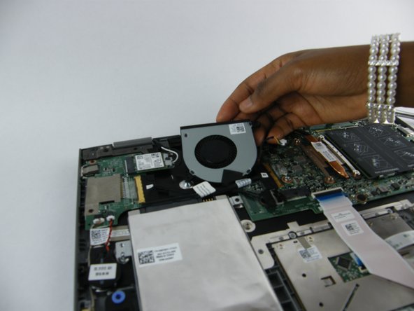

  6. Dell Inspiron 13-5368 Fan Replacement, Fan: crwdns2935265:06crwdnd2935265:01crwdnd2935265:01crwdne2935265:0
    • Remove both of the 2mm X 3mm screws that are securing the fan.
  7. Dell Inspiron 13-5368 Fan Replacement: crwdns2935265:07crwdnd2935265:01crwdnd2935265:02crwdne2935265:0 Dell Inspiron 13-5368 Fan Replacement: crwdns2935265:07crwdnd2935265:02crwdnd2935265:02crwdne2935265:0
    • Unplug the fan from the motherboard by pulling the cable towards the fan. Then remove the fan.
    • Just like the battery, remove the fan by lifting it straight up out of the housing.
