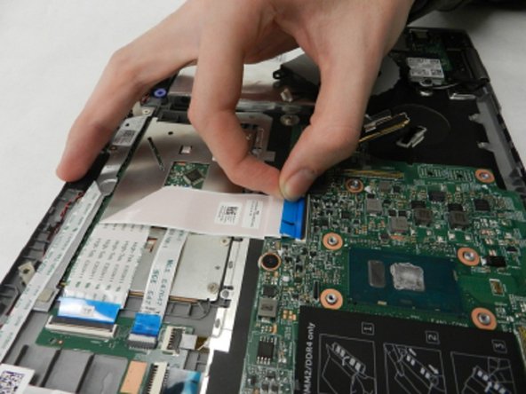

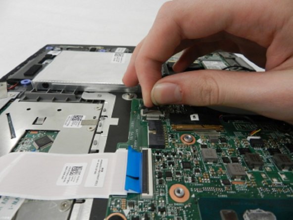

  8. Dell Inspiron 13-5368 Audio Jack Replacement: crwdns2935265:08crwdnd2935265:01crwdnd2935265:03crwdne2935265:0 Dell Inspiron 13-5368 Audio Jack Replacement: crwdns2935265:08crwdnd2935265:02crwdnd2935265:03crwdne2935265:0 Dell Inspiron 13-5368 Audio Jack Replacement: crwdns2935265:08crwdnd2935265:03crwdnd2935265:03crwdne2935265:0
    • Disconnect the following cables that connect to the motherboard: hard drive cable and touchpad cable.
