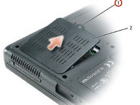

  1. Dell Inspiron 1200 Memory Modules Replacement, Loosen the Screw: crwdns2935265:01crwdnd2935265:01crwdnd2935265:01crwdne2935265:0
  2. Dell Inspiron 1200 Memory Modules Replacement, Popping the Memory Module: crwdns2935265:02crwdnd2935265:01crwdnd2935265:01crwdne2935265:0
    • Use your fingertips to carefully spread apart the securing clips on each end of the memory module connector until the module pops up.
  3. Dell Inspiron 1200 Memory Modules Replacement, Removing the Memory Module: crwdns2935265:03crwdnd2935265:01crwdnd2935265:01crwdne2935265:0
    • Remove the module from the connector.
  4. Dell Inspiron 1200 Memory Modules Replacement, Align the Notch: crwdns2935265:04crwdnd2935265:01crwdnd2935265:01crwdne2935265:0
    • NOTE: If the memory module is not installed properly, the computer may not boot properly. No error message indicates this failure.
    • Align the notch in the module edge connector with the tab in the connector slot.
  5. Dell Inspiron 1200 Memory Modules Replacement, Installing the Module: crwdns2935265:05crwdnd2935265:01crwdnd2935265:01crwdne2935265:0
    • Slide the NEW module firmly into the slot at a 45-degree angle, and rotate the module down until it clicks into place. If you do not feel the click, remove the module and reinstall it.
  6. Dell Inspiron 1200 Memory Modules Replacement, Replace the Cover: crwdns2935265:06crwdnd2935265:01crwdnd2935265:02crwdne2935265:0 Dell Inspiron 1200 Memory Modules Replacement, Replace the Cover: crwdns2935265:06crwdnd2935265:02crwdnd2935265:02crwdne2935265:0
    • Replace the cover and tighten the captive screw.
