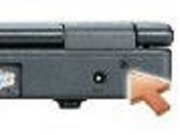

    • From the bottom of the computer, remove the two M2.5 x 5-mm screws labeled "D."
  5. Dell Inspiron 1200 Display Assembly Replacement, Remove the Screws: crwdns2935265:06crwdnd2935265:01crwdnd2935265:01crwdne2935265:0
    • From the back of the computer, remove the two M2.5 x 8-mm screws labeled "D."
