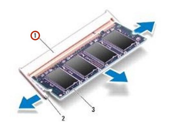

  3. Dell Inspiron 11z-1121 Memory Modules Replacement, Popping up the Memory Module: crwdns2935265:03crwdnd2935265:01crwdnd2935265:01crwdne2935265:0
    • CAUTION: To prevent damage to the memory module connector, do not use tools to spread the memory module securing clips.
    • Use your fingertips to carefully spread apart the securing clips on each end of the memory module connector until the memory module pops up.
  4. Dell Inspiron 11z-1121 Memory Modules Replacement, Removing the Memory Module: crwdns2935265:04crwdnd2935265:01crwdnd2935265:01crwdne2935265:0
    • Remove the memory module from the memory-module connector.
