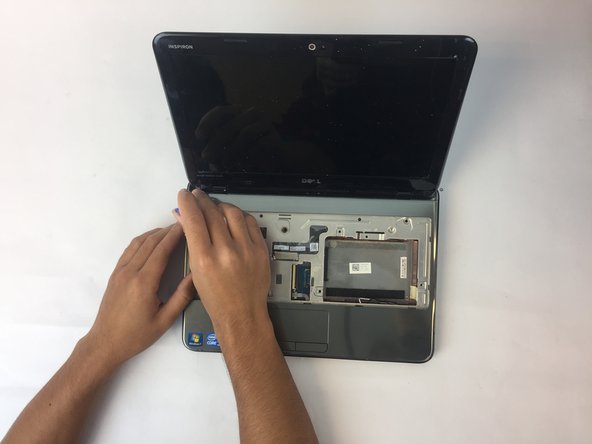

    • Flip the laptop over and open it to expose the keyboard.
    • Use a plastic opening tool to pry up the keyboard, starting in the upper corner and working your way around.
    • Once the keyboard is pried up, do not remove the keyboard. There is still a ribbon attaching the keyboard to the laptop.

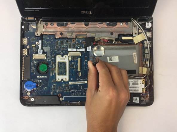

    • Start by prying the outer casing of the laptop using the plastic opening tool. Start from the bottom and work your way around the edges.
  6. Dell Inspiron 11z-1121 Fan Replacement: crwdns2935265:06crwdnd2935265:01crwdnd2935265:02crwdne2935265:0 Dell Inspiron 11z-1121 Fan Replacement: crwdns2935265:06crwdnd2935265:02crwdnd2935265:02crwdne2935265:0
    • Remove the outer casing to expose the motherboard.
    • Remove five .75 mm screws using a PH1 screwdriver.
    • Make sure to keep track of your screws.

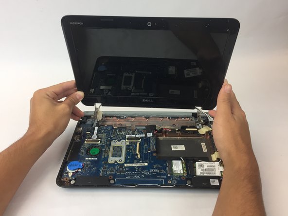

  8. Dell Inspiron 11z-1121 Fan Replacement: crwdns2935265:08crwdnd2935265:01crwdnd2935265:02crwdne2935265:0 Dell Inspiron 11z-1121 Fan Replacement: crwdns2935265:08crwdnd2935265:02crwdnd2935265:02crwdne2935265:0
    • Unscrew the two 0.9 mm screws that are holding down the screen.
    • Lift the screen up and towards yourself to detach the screen from the laptop.

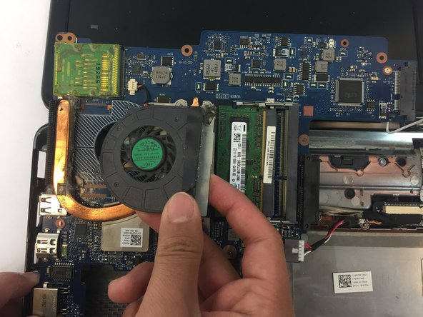

  11. Dell Inspiron 11z-1121 Fan Replacement: crwdns2935265:011crwdnd2935265:01crwdnd2935265:02crwdne2935265:0 Dell Inspiron 11z-1121 Fan Replacement: crwdns2935265:011crwdnd2935265:02crwdnd2935265:02crwdne2935265:0
    • Unscrew the two black 0.5 mm screws holding the fan in place.
    • Remove the fan by gently lifting the component upwards.
