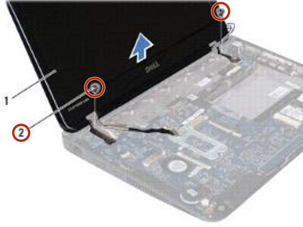

  2. Dell Inspiron 11z 1120 Display Assembly Replacement, Remove the Screws: crwdns2935265:02crwdnd2935265:01crwdnd2935265:01crwdne2935265:0
    • Remove the two screws (one on each side) that secure the display assembly to the computer base.
  3. Dell Inspiron 11z 1120 Display Assembly Replacement, Lifting the Display Assembly: crwdns2935265:03crwdnd2935265:01crwdnd2935265:01crwdne2935265:0
    • Lift and remove the display assembly off the computer base.
