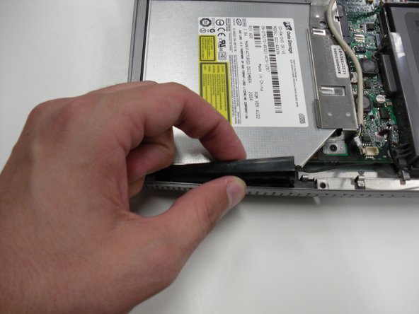

  3. Dell Inspiron 1150 Speaker Replacement, Optical Drive (Based on Dell Service Manual): crwdns2935265:03crwdnd2935265:01crwdnd2935265:03crwdne2935265:0 Dell Inspiron 1150 Speaker Replacement, Optical Drive (Based on Dell Service Manual): crwdns2935265:03crwdnd2935265:02crwdnd2935265:03crwdne2935265:0 Dell Inspiron 1150 Speaker Replacement, Optical Drive (Based on Dell Service Manual): crwdns2935265:03crwdnd2935265:03crwdnd2935265:03crwdne2935265:0
    • Place laptop upsid down on a clean flat work surface.
    • Remove the Philips M2.5 x 8 mm screw
    • Loosen the screw that holds the memory compartment closed
    • remove the memory module compartment cover
    • Press the Optical Drive release lever to the right and the optical drive should slide out of the case

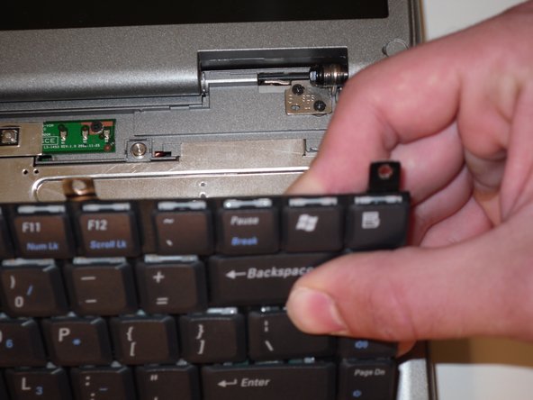

  4. Dell Inspiron 1150 Speaker Replacement, Keyboard: crwdns2935265:04crwdnd2935265:01crwdnd2935265:03crwdne2935265:0 Dell Inspiron 1150 Speaker Replacement, Keyboard: crwdns2935265:04crwdnd2935265:02crwdnd2935265:03crwdne2935265:0 Dell Inspiron 1150 Speaker Replacement, Keyboard: crwdns2935265:04crwdnd2935265:03crwdnd2935265:03crwdne2935265:0
    • Use a spudger to lift the notched right edge of the hinge cover, and pry it loose
    • You need to lay the LCD screen down flat to allow the hinge cover to be lifted off
    • Lift the hinge cover off and set aside

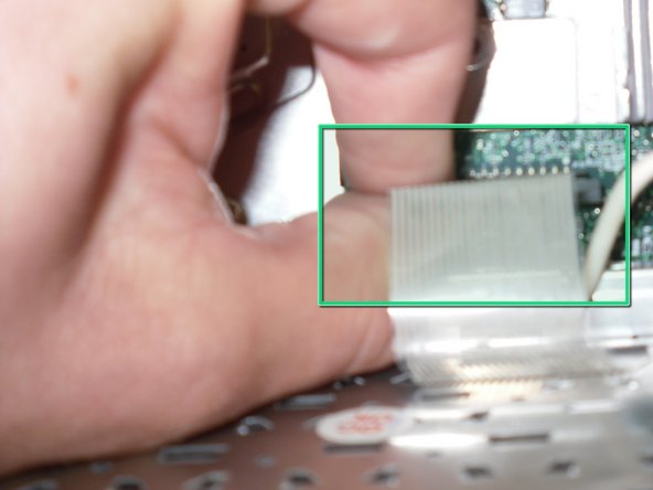

    • Lift up keyboard from the rear to expose the connector below
    • Disconnect the keyboard ribbon cable from the mother board

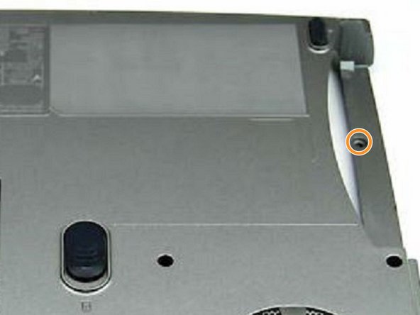

  8. Dell Inspiron 1150 Speaker Replacement, Palm Rest: crwdns2935265:08crwdnd2935265:01crwdnd2935265:02crwdne2935265:0 Dell Inspiron 1150 Speaker Replacement, Palm Rest: crwdns2935265:08crwdnd2935265:02crwdnd2935265:02crwdne2935265:0
    • Position the computer upside down on a clean, flat surface.
    • Remove the twelve M2.5 × 8 mm screws from the bottom case.
    • Remove the M2.5 × 4 mm screw from the battery bay.

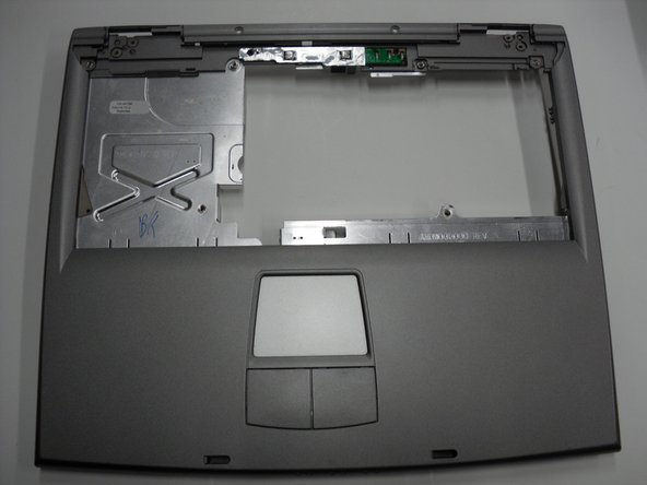

  9. Dell Inspiron 1150 Speaker Replacement: crwdns2935265:09crwdnd2935265:01crwdnd2935265:02crwdne2935265:0 Dell Inspiron 1150 Speaker Replacement: crwdns2935265:09crwdnd2935265:02crwdnd2935265:02crwdne2935265:0
    • Position the computer keyboard side up.
    • Remove the two M2.5 × 5 mm screws from the top edge of the palm rest.
    • Disconnect the touchpad (mouse-pad) ribbon cable from the main board by lifting the locking bar and pulling the cable straight out.
    • Starting at the back center, lift the inside edge of the palm rest to release the clips, then work toward the sides.
    • Caution: The palm-rest plastic and touchpad ribbon cable are fragile. Use gentle force and keep the cable clear while lifting to avoid tearing it.

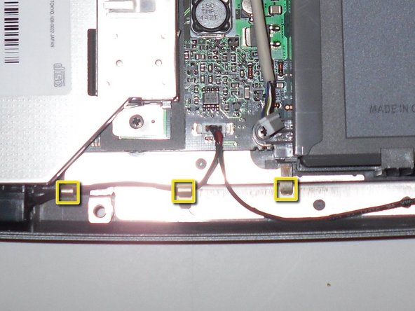

  10. Dell Inspiron 1150 Speaker Replacement, Speaker: crwdns2935265:010crwdnd2935265:01crwdnd2935265:03crwdne2935265:0 Dell Inspiron 1150 Speaker Replacement, Speaker: crwdns2935265:010crwdnd2935265:02crwdnd2935265:03crwdne2935265:0 Dell Inspiron 1150 Speaker Replacement, Speaker: crwdns2935265:010crwdnd2935265:03crwdnd2935265:03crwdne2935265:0
    • The speakers are located along the front of the laptop
    • Disconnect the cables from the main board
    • Unclip the cables from the wire retainers
    • Pull straight up and out to remove the speakers
