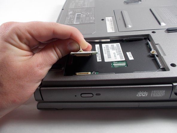

    • Unscrew the one Phillips #0 screw at the bottom of the panel and remove the panel.
    • The screw does not separate from the cover. Be sure the screw is completely unscrewed before using force to remove the cover.
  2. Dell Inspiron 1100 Wireless Card Replacement: crwdns2935265:02crwdnd2935265:01crwdnd2935265:02crwdne2935265:0 Dell Inspiron 1100 Wireless Card Replacement: crwdns2935265:02crwdnd2935265:02crwdnd2935265:02crwdne2935265:0
    • Unscrew the two 3mm Phillips #0 screws located on the card.
    • Be careful, as these screws are easy to strip.
  3. Dell Inspiron 1100 Wireless Card Replacement: crwdns2935265:03crwdnd2935265:01crwdnd2935265:02crwdne2935265:0 Dell Inspiron 1100 Wireless Card Replacement: crwdns2935265:03crwdnd2935265:02crwdnd2935265:02crwdne2935265:0
    • Pull the white plastic tab on top of the card straight up to remove the card.
    • This step requires some light force. Be sure the screws from the previous step have been removed.
  4. Dell Inspiron 1100 Wireless Card Replacement: crwdns2935265:04crwdnd2935265:01crwdnd2935265:01crwdne2935265:0
    • Use blunt nose tweezers to remove the power cable from the wireless card.
    • Make sure the tweezers are only gripping the head of the power cable and not any part of the wireless card, as this may damage the card.

I believe that is a phone modem, not a wireless card. Might be wrong though.
George A. - crwdns2934203:0crwdne2934203:0
i think your right as dell 1100 dont have a wifi slot only can use usb or pcmcia card
Conner Peden - crwdns2934203:0crwdne2934203:0
