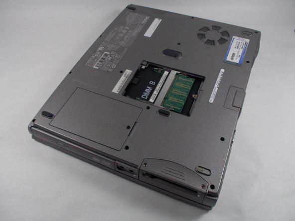

    • Remove the one Phillips #0 screw at the bottom-center of the panel covering the RAM and remove the panel.
    • The screw does not separate from the cover. Be careful when using force to remove the cover as the screw may not be completely unscrewed.
  2. Dell Inspiron 1100 RAM Replacement: crwdns2935265:02crwdnd2935265:01crwdnd2935265:02crwdne2935265:0 Dell Inspiron 1100 RAM Replacement: crwdns2935265:02crwdnd2935265:02crwdnd2935265:02crwdne2935265:0
    • Use your hands to pull the two metal tabs away from the RAM.
    • The RAM will rise out when clear of the metal tabs. Do not force it into the up position.
  3. Dell Inspiron 1100 RAM Replacement: crwdns2935265:03crwdnd2935265:01crwdnd2935265:02crwdne2935265:0 Dell Inspiron 1100 RAM Replacement: crwdns2935265:03crwdnd2935265:02crwdnd2935265:02crwdne2935265:0
    • Pull out the RAM.
    • Be careful not to touch the metal contacts on the bottom of the RAM as this may damage it.
    • Store the RAM in an anti-static bag or a non-conductive surface, such as a stone or wooden table.
