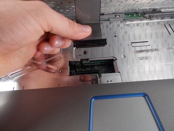

    4. Dell Inspiron 1100 Keyboard Replacement: crwdns2935265:04crwdnd2935265:01crwdnd2935265:02crwdne2935265:0 Dell Inspiron 1100 Keyboard Replacement: crwdns2935265:04crwdnd2935265:02crwdnd2935265:02crwdne2935265:0
      • Grip the ribbon on its hard plastic connector, and pull the ribbon and its connector out of the motherboard header.
      • Do not pull on the ribbon itself, as this may cause internal damage to the connector.
