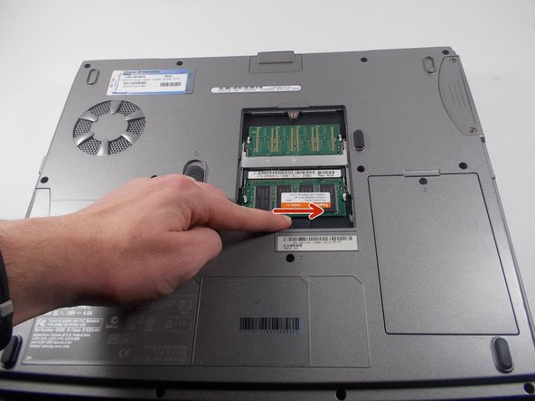

  3. Dell Inspiron 1100 CD Drive Replacement: crwdns2935265:03crwdnd2935265:01crwdnd2935265:02crwdne2935265:0 Dell Inspiron 1100 CD Drive Replacement: crwdns2935265:03crwdnd2935265:02crwdnd2935265:02crwdne2935265:0
    • Push and hold the switch inside the RAM compartment to the right.
    • This will cause the CD Drive to be slightly pushed out of its slot.
    • If the switch cannot be moved, check to make sure you have completed the first step in this guide.

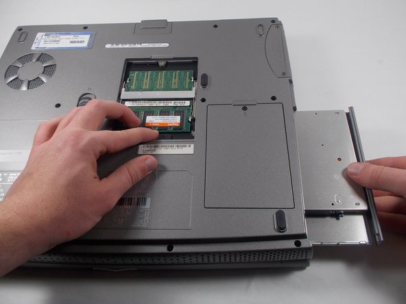

  4. Dell Inspiron 1100 CD Drive Replacement: crwdns2935265:04crwdnd2935265:01crwdnd2935265:02crwdne2935265:0 Dell Inspiron 1100 CD Drive Replacement: crwdns2935265:04crwdnd2935265:02crwdnd2935265:02crwdne2935265:0
    • While holding down the switch in the RAM compartment, pull out the CD Drive.
