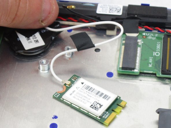

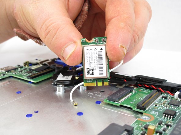

  8. Dell Inspiron 11-3168 Wifi module Replacement: crwdns2935265:08crwdnd2935265:01crwdnd2935265:03crwdne2935265:0 Dell Inspiron 11-3168 Wifi module Replacement: crwdns2935265:08crwdnd2935265:02crwdnd2935265:03crwdne2935265:0 Dell Inspiron 11-3168 Wifi module Replacement: crwdns2935265:08crwdnd2935265:03crwdnd2935265:03crwdne2935265:0
    • To remove the WiFi module from the motherboard, slide it free of the socket connector.
  9. Dell Inspiron 11-3168 Wifi module Replacement: crwdns2935265:09crwdnd2935265:01crwdnd2935265:03crwdne2935265:0 Dell Inspiron 11-3168 Wifi module Replacement: crwdns2935265:09crwdnd2935265:02crwdnd2935265:03crwdne2935265:0 Dell Inspiron 11-3168 Wifi module Replacement: crwdns2935265:09crwdnd2935265:03crwdnd2935265:03crwdne2935265:0
    • Disconnect both the black and the white wires from the WiFi module.
