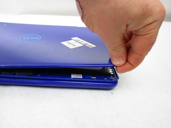

  2. Dell Inspiron 11-3168 Screen Replacement: crwdns2935265:02crwdnd2935265:01crwdnd2935265:03crwdne2935265:0 Dell Inspiron 11-3168 Screen Replacement: crwdns2935265:02crwdnd2935265:02crwdnd2935265:03crwdne2935265:0 Dell Inspiron 11-3168 Screen Replacement: crwdns2935265:02crwdnd2935265:03crwdnd2935265:03crwdne2935265:0
    • Remove the bottom case of the laptop by gently prying along the seam with a plastic opening tool.

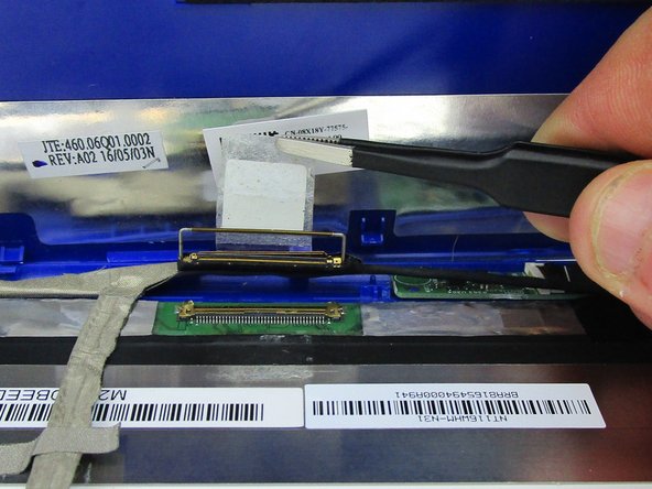

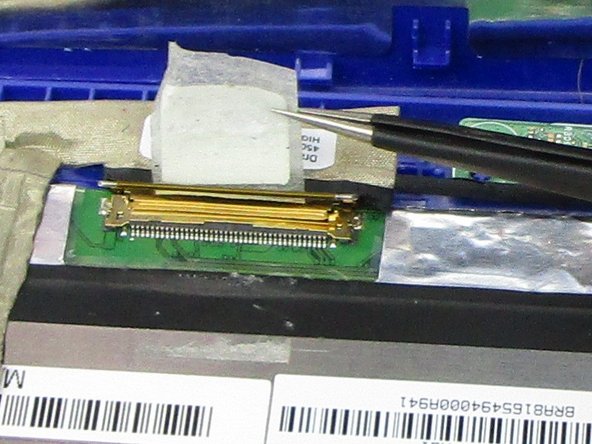

  7. Dell Inspiron 11-3168 Screen Replacement: crwdns2935265:07crwdnd2935265:01crwdnd2935265:03crwdne2935265:0 Dell Inspiron 11-3168 Screen Replacement: crwdns2935265:07crwdnd2935265:02crwdnd2935265:03crwdne2935265:0 Dell Inspiron 11-3168 Screen Replacement: crwdns2935265:07crwdnd2935265:03crwdnd2935265:03crwdne2935265:0
    • Use a pair of tweezers to grip the tape that is holding down the display cable clip.
    • Gently unpeel the tape. This will release the clip that locks over the display connector socket.
    • Once unclipped, remove the display cable from the socket.

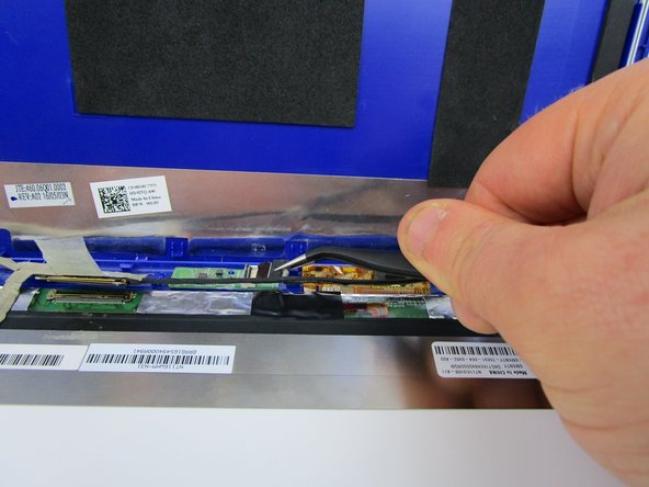

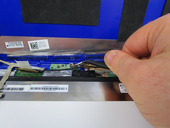

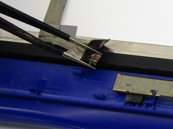

  8. Dell Inspiron 11-3168 Screen Replacement: crwdns2935265:08crwdnd2935265:01crwdnd2935265:03crwdne2935265:0 Dell Inspiron 11-3168 Screen Replacement: crwdns2935265:08crwdnd2935265:02crwdnd2935265:03crwdne2935265:0 Dell Inspiron 11-3168 Screen Replacement: crwdns2935265:08crwdnd2935265:03crwdnd2935265:03crwdne2935265:0
    • Find the smaller ZIF connector. Using tweezers, carefully lift the black flap on the connector to release the ribbon cable.
  9. Dell Inspiron 11-3168 Screen Replacement: crwdns2935265:09crwdnd2935265:01crwdnd2935265:02crwdne2935265:0 Dell Inspiron 11-3168 Screen Replacement: crwdns2935265:09crwdnd2935265:02crwdnd2935265:02crwdne2935265:0
    • Disconnect the webcam module located at the top of the monitor.

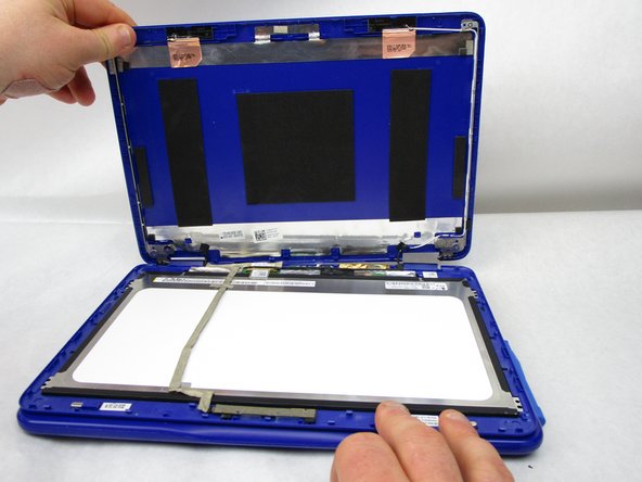

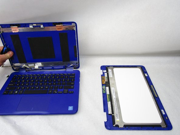

  10. Dell Inspiron 11-3168 Screen Replacement: crwdns2935265:010crwdnd2935265:01crwdnd2935265:02crwdne2935265:0 Dell Inspiron 11-3168 Screen Replacement: crwdns2935265:010crwdnd2935265:02crwdnd2935265:02crwdne2935265:0
    • Lift and remove the display screen from the top case.
