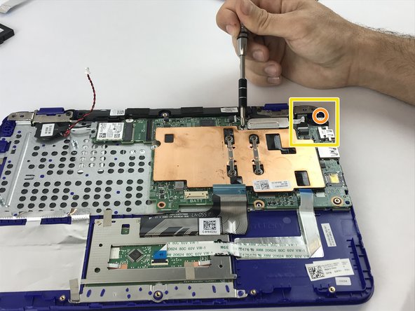

  7. Dell Inspiron 11-3164 Keyboard Replacement: crwdns2935265:07crwdnd2935265:01crwdnd2935265:02crwdne2935265:0 Dell Inspiron 11-3164 Keyboard Replacement: crwdns2935265:07crwdnd2935265:02crwdnd2935265:02crwdne2935265:0
    • With tweezers, unplug the DC Jack cable.
    • With the Philips #0 Screwdriver, loosen the M2 x 3mm screw.
    • With tweezers, detach the DC Jack.

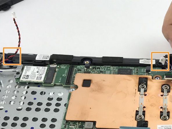

  8. Dell Inspiron 11-3164 Keyboard Replacement: crwdns2935265:08crwdnd2935265:01crwdnd2935265:02crwdne2935265:0 Dell Inspiron 11-3164 Keyboard Replacement: crwdns2935265:08crwdnd2935265:02crwdnd2935265:02crwdne2935265:0
    • With tweezers, disconnect the speaker cable.
    • With tweezers, detach the speaker.
  9. Dell Inspiron 11-3164 Keyboard Replacement: crwdns2935265:09crwdnd2935265:01crwdnd2935265:02crwdne2935265:0 Dell Inspiron 11-3164 Keyboard Replacement: crwdns2935265:09crwdnd2935265:02crwdnd2935265:02crwdne2935265:0
    • With the Philips #0 Screwdriver, unbolt the M2 x 3mm screw.
    • Remove the metal bracket.
    • With tweezers, disconnect the display cable.

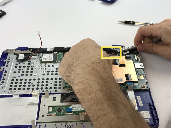

  11. Dell Inspiron 11-3164 Keyboard Replacement: crwdns2935265:011crwdnd2935265:01crwdnd2935265:01crwdne2935265:0
    • With the Philips #0 Screwdriver, loosen the 4 screws supporting the copper plate.
    • With tweezers, remove the copper plate.
  12. Dell Inspiron 11-3164 Keyboard Replacement: crwdns2935265:012crwdnd2935265:01crwdnd2935265:02crwdne2935265:0 Dell Inspiron 11-3164 Keyboard Replacement: crwdns2935265:012crwdnd2935265:02crwdnd2935265:02crwdne2935265:0
    • With tweezers, disconnect the keyboard cable.
    • With tweezers, disconnect the touchpad cable.
    • With the Philips #00 Screwdriver, loosen the four (4) M2 x 2mm screws.
    • Gently remove the mouse touchpad. The fixer is left with the palm-rest and keyboard assembly.
