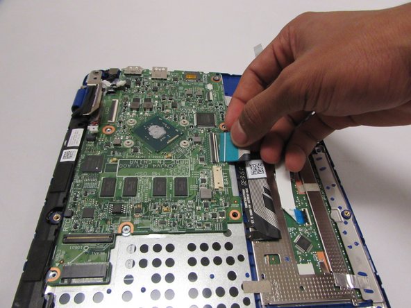

    • Remove the keyboard cable.
  17. Dell Inspiron 11-3162 Palmrest Keyboard Replacement: crwdns2935265:017crwdnd2935265:01crwdnd2935265:01crwdne2935265:0
    • Remove the motherboard by gently lifting upwards from the edges.
